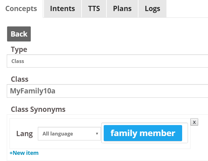

Class Synonyms
The DS1. uses the values in this field for collecting/asking missing information, a process we call clarification, which will be discussed later.
1. DS stands for dialogue system, and we will continue using this acronym in this tutorial.

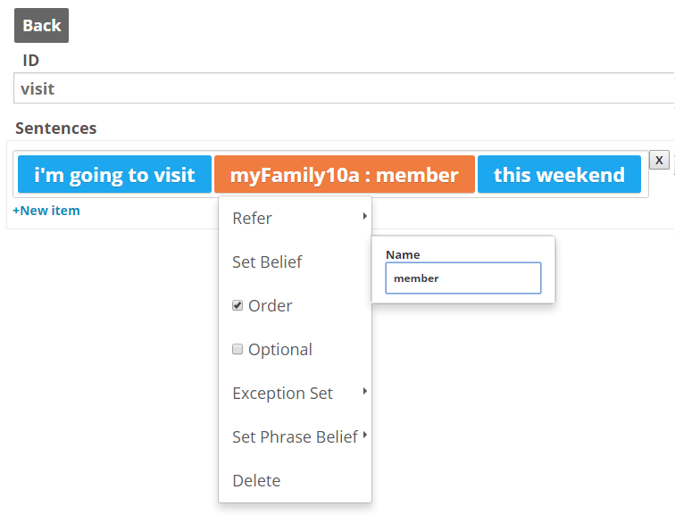

Here is an example. In Fig. 1, in the Concepts tab page, we see that there are a class with ID=myFamily10a and a class synonym family member. In addition, in Fig. 2, in the intent tab page, we have a sentence referencing the myFamily10a class, where we set a belief called member. Then suppose a speaker fails to provide the information of the family member. (For example, s/he might say, "I am going to visit.") In this case, the DS will need further clarification, a process done by asking a clarifying question inquiring the missing information.
What will the DS do about it? Well, in the plan tab page, if we have defined one or more prompts for the belief, the DS will ask the speaker a question according to whatever the message(s) stored inside the prompt field. However, let's assume we forgot to define any prompts for the belief. Then based on our system design, if the class synonym field is empty, the DS will try to clarify what s/he said through a series of clarifying questions, only to be able to ask something such as "What's your myFamily10a?", which, depending on the class ID (Often a class ID is just a meaningless combination of digits, along with some letters.), might be, as you can see, rather confusing to an app developer, not to mention to the speaker. On the other hand, supposing we have defined a class synonym called family member, the DS can instead ask clarifying questions such as "What's your family member?”, which obviously makes much more sense.

Fig. 1. Class Synonyms.
Fig. 2. A sentence that references the myFamily10a class

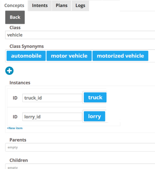

Let's look at another example. Were I a seller of cars, in Fig. 3-a, I would want to define a vehicle class and then instantiate it by creating all the types of vehicles I sell, such as trucks and cars. Thus, in Fig. 3-a, we create a class named vehicle, which is synonymous with Automobile, motor vehicle, motorized vehicle, and instantiate two instances with different IDs, one of which is truck_id, the other lorry_id. The first instance is called truck, and the second, lorry. Note that there are only instances of words (which are the opposite of phrases) created in the vehicle class. A word is the opposite of a phrase and can be distinguished from a phrase by its color---a word icon is in blue, and a phrase icon, by contrast, in purple.

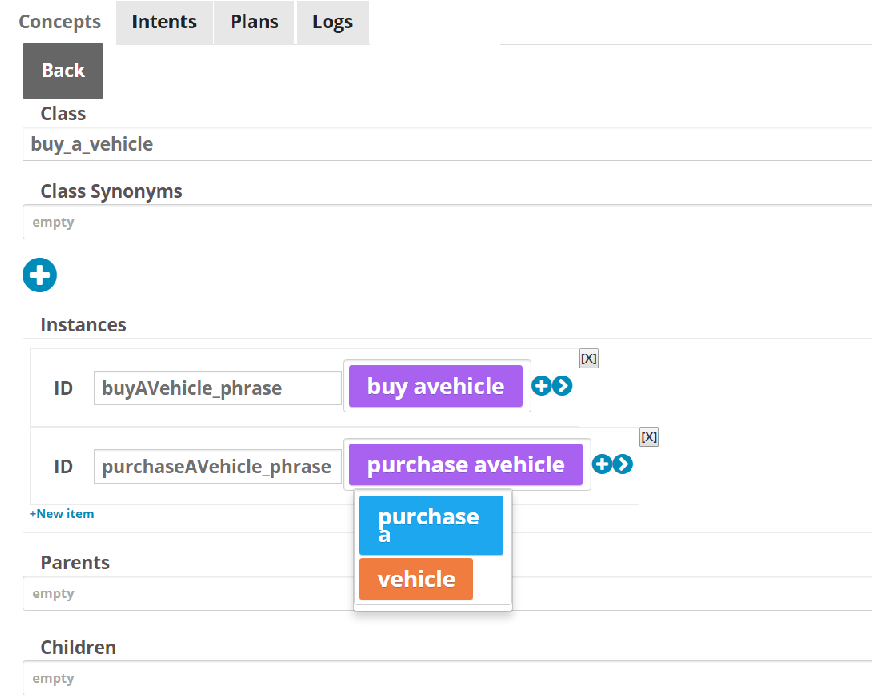

In Fig. 3-b, we create a class named buy_a_vehicle, and as its name suggested, this class ought to mean something like buying a vehicle, of which the sentence structure should be a verb following by an object, thus forming a phrase. The first instance the class instantiates is called buy a vehicle, a phrase composed of two words (“buy” and “a”) and a class (vehicle). After combining them together, the instance becomes a phrase (buy a vehicle). Similarly, the second instance is made up of two words (“purchase” and “a”) and the vehicle class, thereby forming a phrase (purchase a vehicle).

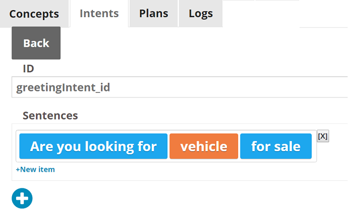

Fig. 3-c shows the sentence "Are you looking for {the vehicle class} for sale?", which can represent either:
Are you looking for a + truck + for sale?
or
Are you looking for a + lorry + for sale?
Note that you might have noticed in Fig. 3-c, there is no article in front of the word vehicle, and that it seems obviously ungrammatical. The reason is that stop words (such as a, an, the) can be omitted while defining sentences. Our system won't take stop words into consideration.

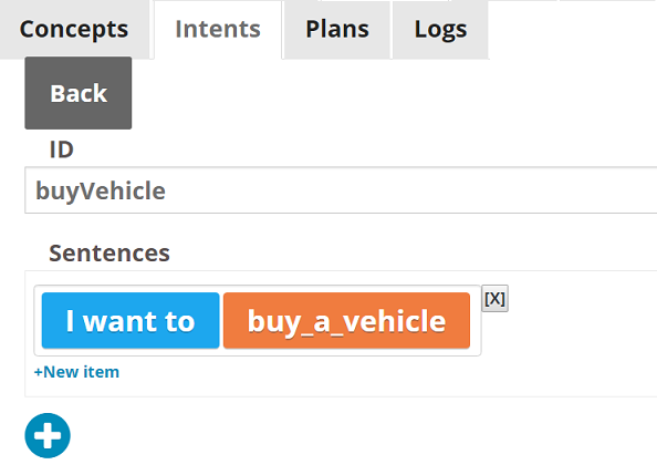

Fig. 3-d shows the sentence "I want to {the buy_a_vehicle phrase}.", which can represent:
I want to buy a truck.
I want to buy a lorry.
I want to purchase a truck.
I want to purchase a lorry.

Fig. 3-a. Define a class with instances of words.
Fig. 3-b. Define a class with instances of phrases.

Fig. 3-d. Sentence definition containing phrases.

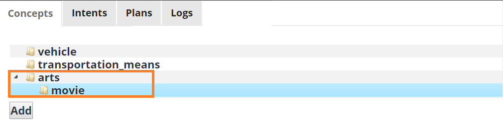

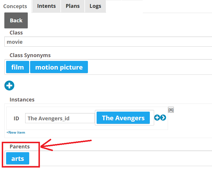

The Parents of a Class
You can also define a hierarchy between concepts by specifying which is whose parent, thus making classes more organized.
In Fig. 5, we can see a hierarchy of the concepts arts and movie. The movie class has the parent arts. Thus, all the instances belonging to the movie class are the instances of the arts class.
In Fig. 6, you can see the movie class is under the arts class.
Fig 5. Define the parents of the movie class.
Fig. 6. Hierarchy trees.
