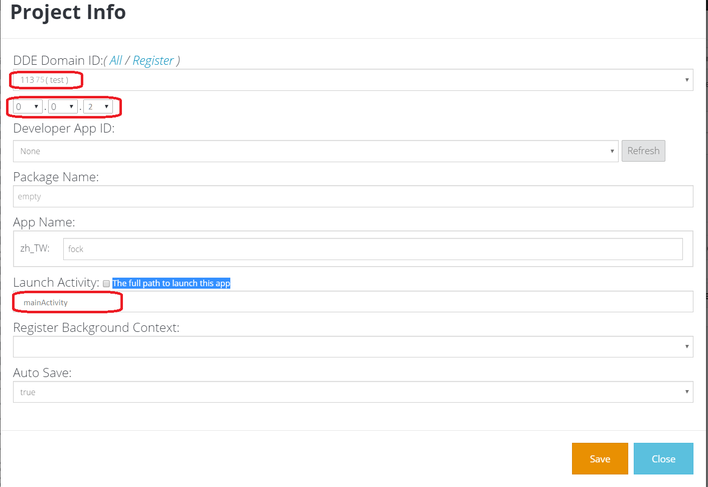

Open the DDE project according to the domain ID and version of the APK file.
Step 2. Fill out Project Info
In Project Info, make sure you have filled in the same domain ID and domain version as those in the apk manifest file. In addition, fill in the blanks of Launch Activity, Developer App ID, Register background contexts, etc. Check the "The full path to launch this app" box if it's a full path. A developer App ID, which is managed by the developer site, belongs exclusively to the app you are designing. Thus, basically every pre-load app account has a set of developer app IDs to be chosen.

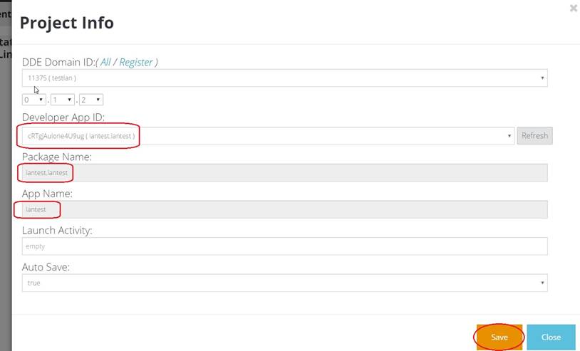

Step 3.
Choose a Developer App ID, whose value cannot be none. Having chosen an ID, you will see our system automatically fills in the blanks of Package Name and App Name for you. Then click Save.

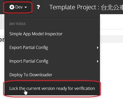

Step 4.
To lock the version, in the upper-left corner, click Dev -> Lock the current version ready for verification.
  • All sentence databases of the DS domains + versions that have once been locked were backuped and fixed forever. Should there be any changes in these sentence databases of a released apk, update the DS domain version and lock it on more time.

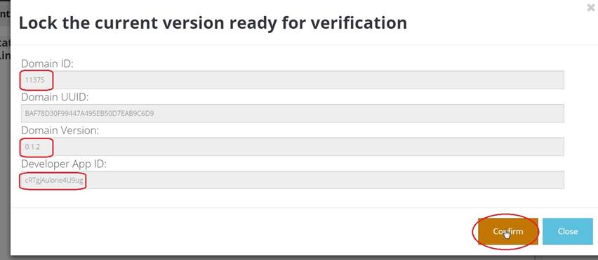

Step 5.
Again, please be sure that the domain ID, version, and developer app ID are correct. And click Confirm.
Step 6.
If all the information is correct and the domain ID and version have never been locked before, the locking process should succeed.
Otherwise, if the domain ID and version have been locked before, the process will fail. In this case, your app will need a different version number in order for the locking process to succeed.
