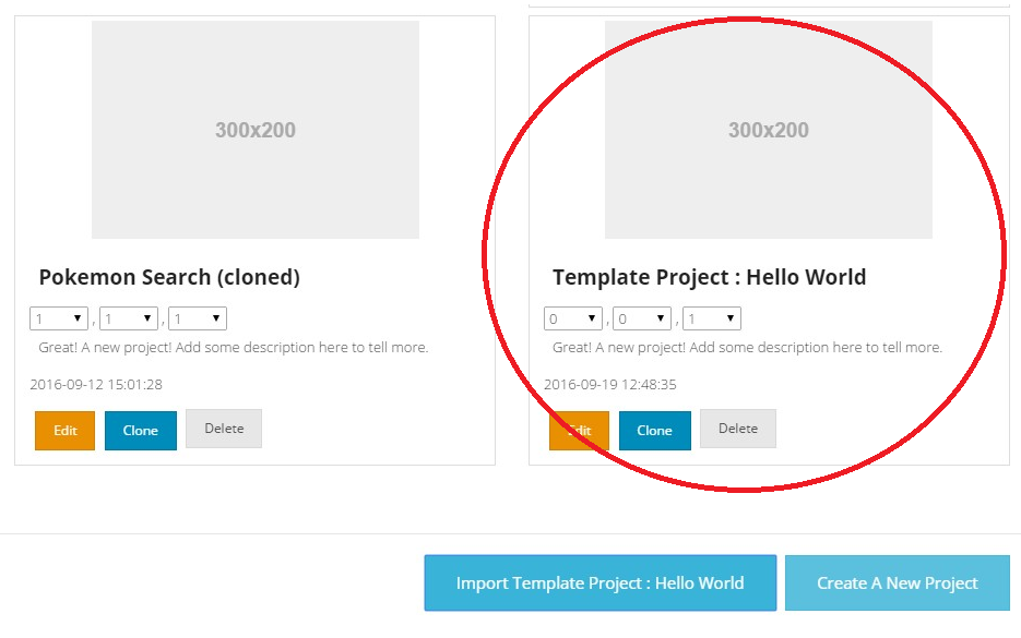

Part 1: Import Sample Project : Hello World
In the DDE editor, you can easily import the Hello World Sample Project by clicking project -> project center ->“Import Template Project: Hello World”
Fig. 1. This figure shows the button to import the sample project.
Fig. 2. The figure shows the result after importing the sample project.

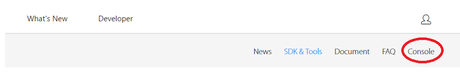

Part 2: Fill your app’s package name, activity name, and get your app key ID in the Console of the Developer Site.
Before you start using the DDE Editor, you should register the info of your app (such as 1. Package Name 2. App Name 3. Activity Name, etc.,) in the App Key Management page by clicking Console in the upper right corner(see figure 3), and after completing some more operations illustrated below, you will be assigned an app key ID for this app (with the corresponding package name, activity name, app name, etc.).

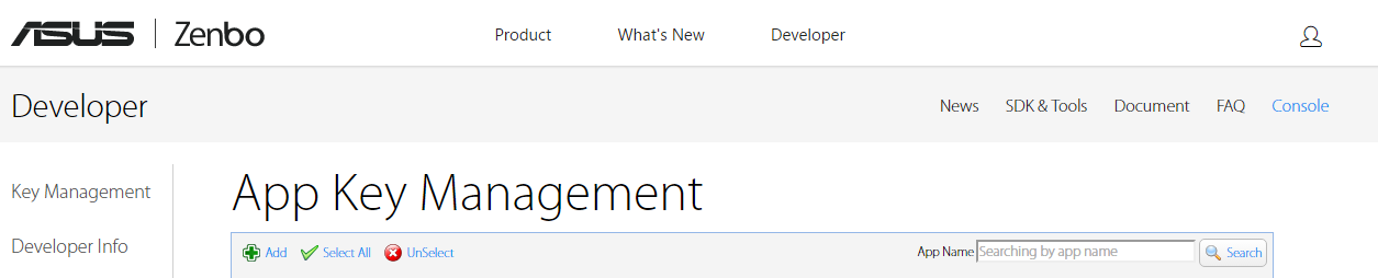

Fig. 3. The figure shows where the Console button is.

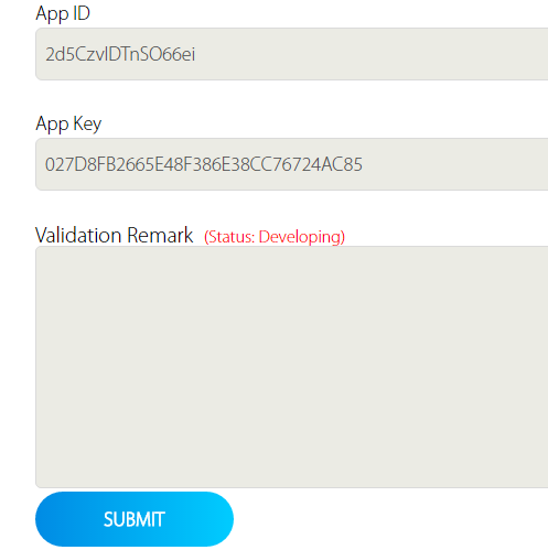

After getting in the console page (if you have not logged-in, the website will ask you to log in), you will see the App Key Management page as figure 4 below:
Fig. 4. The figure shows the App Key Management Page.

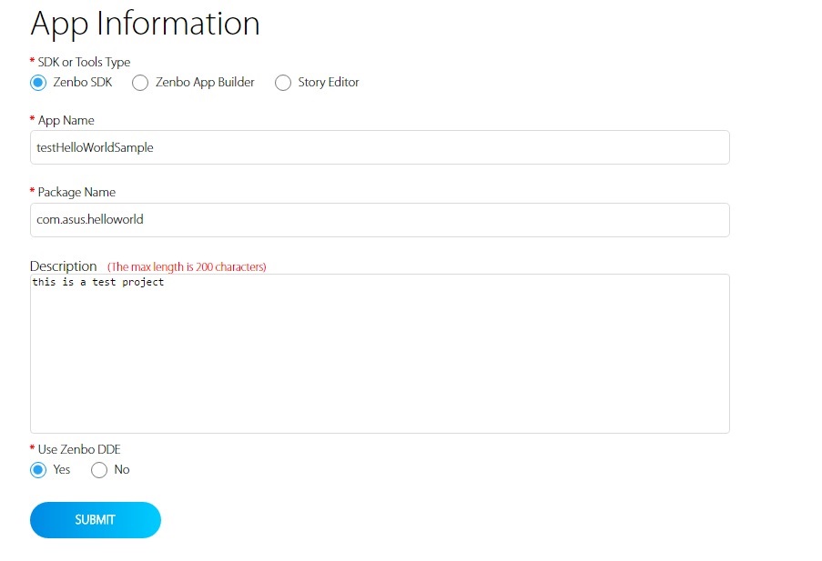

You can click “Add” to register a new app. Now you should predefine some static info here and maybe follow the default grey-out text in some fields.
Fig. 5. The figure shows you an example of how to fill the app related info to get an app key ID.
After pressing SUBMIT, you will get an app key like below:
Fig. 6. The figure shows you the results if submitted successfully.

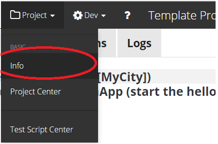

By clicking Project -> Info, you can choose an app ID as the figure below:
Fig. 7.  The figure shows you how to go to the place to enter the app-specific info.

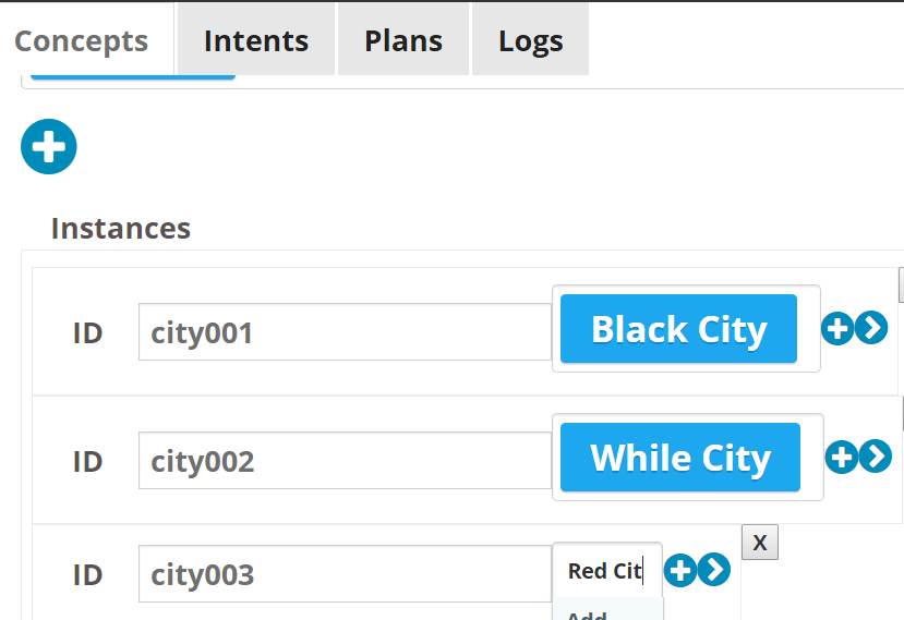

In the Concepts Tab Page

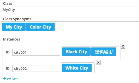

In our Hello World app, there are three concepts, one of which is called MyCity. Click it, and you will see two instances: city001(Black City) and city002(White City).
Fig. 12. An overview of Concepts.
Fig. 13. Detailed info of  the class MyCity.

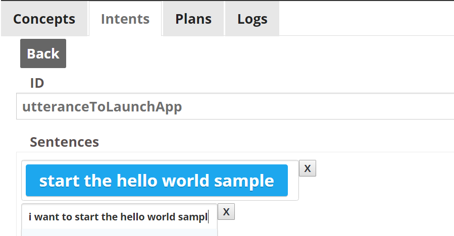

  1. Let's take a look at utteranceToLanuchApp first.
Fig. 15. Detailed info of the intent utteranceToLaunchApp.

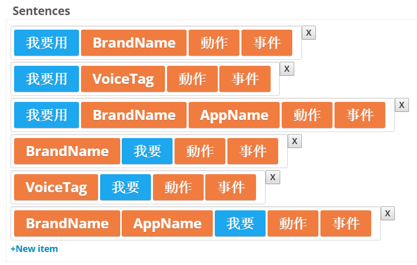

This intent is a cross intent, meaning saying one of these sentences to Zenbo will launch the Hello World app. Please pay particular attention to the patterns of these sentences. Follow these patterns when creating cross intents. If your app contains a cross intent sentence whose pattern is different from the above ones, your app will be rejected when you try to publish it.
An app can have more than one cross intent, but every cross intent must have the above six sentences, and every sentence has its unique pattern to follow.

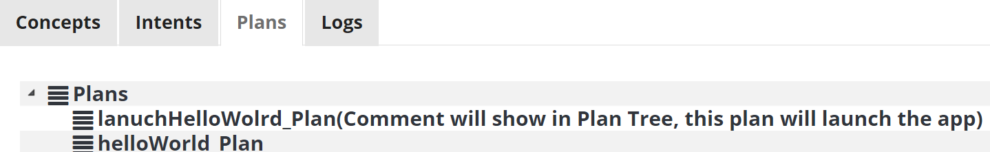

In the Plan Tab Page
There are two Plans:
Fig. 17. An overview of Plans.

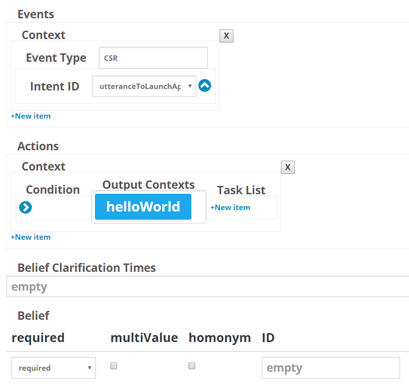

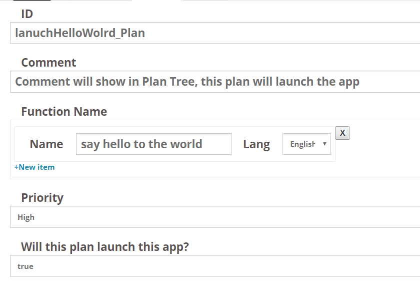

  1. Plan lanuchHelloWolrd_Plan.
Fig. 18. Part 1 of detailed info of lanuchHelloWolrd_Plan.
Fig. 19. Part 2 of detailed info of lanuchHelloWolrd_Plan.
The settings of “will this plan launch your app” in lanuchHelloWolrd_Plan is true so that this is an entry Plan for this app. When an user utterance hits the intent “utteranceToLanuchApp”(a csr event), and since there is no required belief needed to be collected, the Plan is triggered. Once this Plan is triggered, the Action is to choose a matched condition (In this case, it is the “always” condition that is matched.) and then set the next context to “helloWorld” to be listened by the DS.

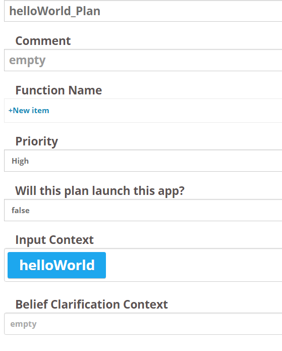

Fig. 20. Part 1 of detailed info of helloWorld_Plan.
Fig. 21. Part 2 of detailed info of helloWorld_Plan.
The setting of “will this plan launch your app” in helloWolrd_Plan is false, so there must define an input context inside (In this case, it is defined as “helloWorld”, which is a trigger condition of this plan.).
Once the context stack "helloWorld" comes, and the user utterance hits the intent “userSayHello”, since there is a required Belief “myCity1”in this Plan, this Plan will start to check if the value of the required belief (myCity1) is already acquired from an user utterance; if not, the DS will seek  clarification “can you tell me what city you are from?”, which is defined in the prompts of myCity1. If all the beliefs set to "required" are acquired, this Plan is  triggered. However, the system will give up this plan after attempting clarification four times.
Once this Plan is triggered, the Action is to choose a matched condition (In this case, it is the “always” condition), and then set an empty output context to be listened by the DS. Then the System will display the response “welcome to my city”. You can usually easily control when to respond by getting the string and call the TTS API in the Zenbo SDK).

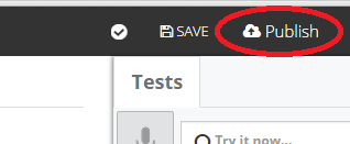

Part 4: Publish your Hello World project
Now that you have linked your own specific app key ID and the sample project together, you can now publish your project.
Fig. 22. The figure shows the button to Publish the project.

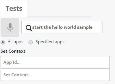

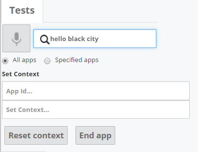

After publishing your app, before you test it on real devices, you can do a quick and simple test on the DDE editor.
Please input “start the hello world sample” or "開啟第一個測試" and press enter.
Fig. 23. Simple test of the hello world project.

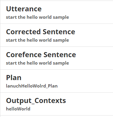

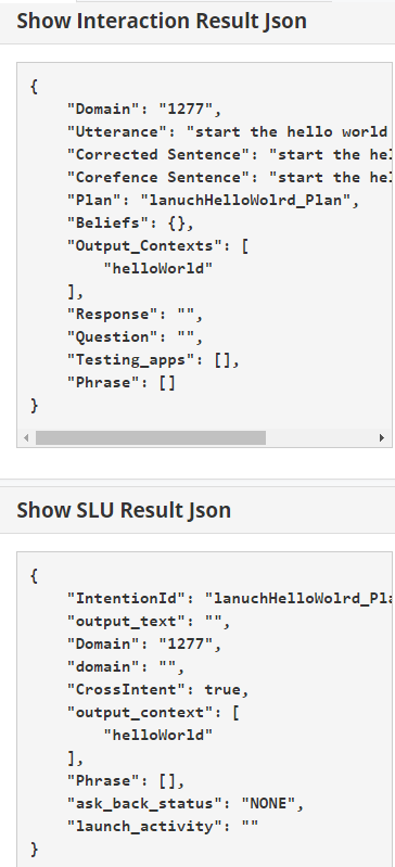

Now you will see the response as below:
Fig. 24. Simple test result of hello world project.
Fig. 25. Simple test json result of hello world project.
Note:  “start the hello world sample” or "開啟第一個測試" is defined in the utteranceToLaunchApp intent, and lanuchHelloWolrd_Plan has defined utteranceToLaunchApp as its CSR event. That is, once the CSR event “utteranceToLaunchApp”  happens,  the Plan is triggered.

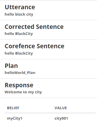

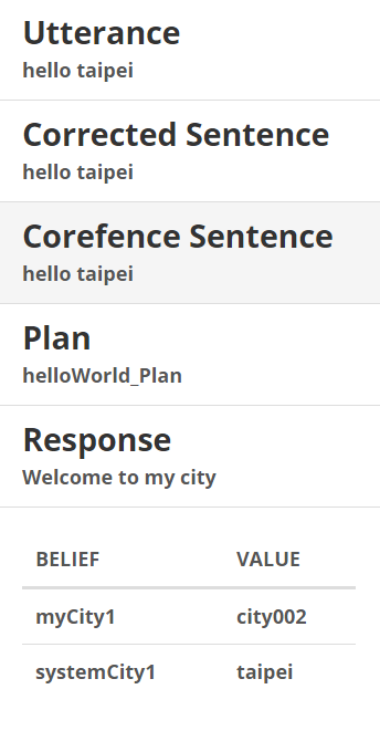

You can then input “hello black city” and press Enter.
Fig. 26. Simple test of hello world project.
You will then get:
Fig. 27. Simple test result of hello world project.
Fig. 28. Simple test result of hello world project.

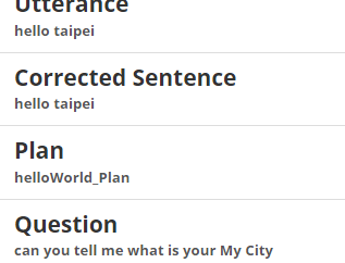

Now, let’s try again quickly by the following steps:
  1. Reset context
  2. Input “start the hello world sample”  or "開啟第一個測試" and press enter
  3. Input “hello taipei” or "哈囉黑色城市"
Now , you will see a system clarification like below:
Fig. 29. Example of the system trying to do clarification to get the required Belief.
Why it happened?

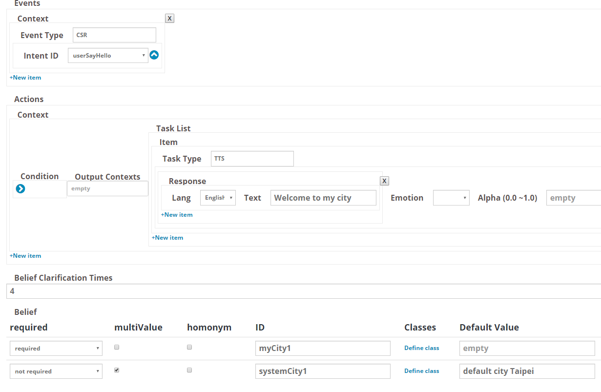

Notice that under the belief setting in plan “helloWorld_Plan”, you will find that there are two beliefs.
Fig. 30. Review belief setting in helloWorld_Plan.
Regarding the first row, myCity1 is set to “required”, which means before you execute your task defined in this plan, you must get the value from the user, or the system will ask for clarification based on the prompt of this belief.

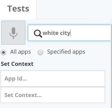

And how to interact with the system? Try inputting “white city”.
Fig. 31. Example answer of the clarification.
Fig. 32. Example of the result after the user answered the clarification,
notice that there are two beliefs extracted from the user utterance here.

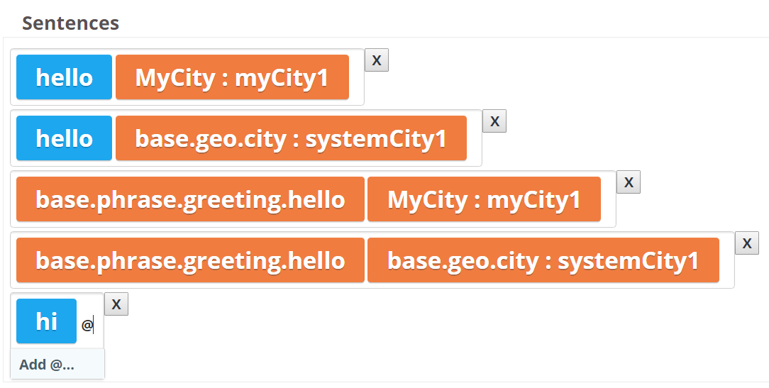

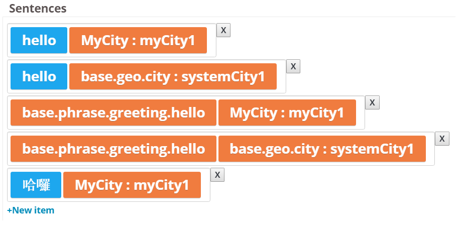

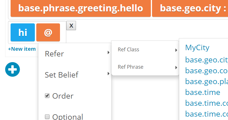

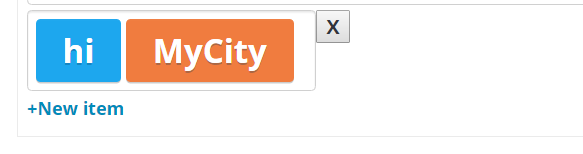

Note that you can reference a concept using an "@", and then press "Enter" to get the orange UI as below :
Fig. 36. An example of referencing a concept as slot in a sentence.
Fig. 37. An example of referencing an app-specific concept as slot in sentence.
In Fig. 37, the expression means that the user utterance “hi black city” and “hi white city” will both hit the intent.

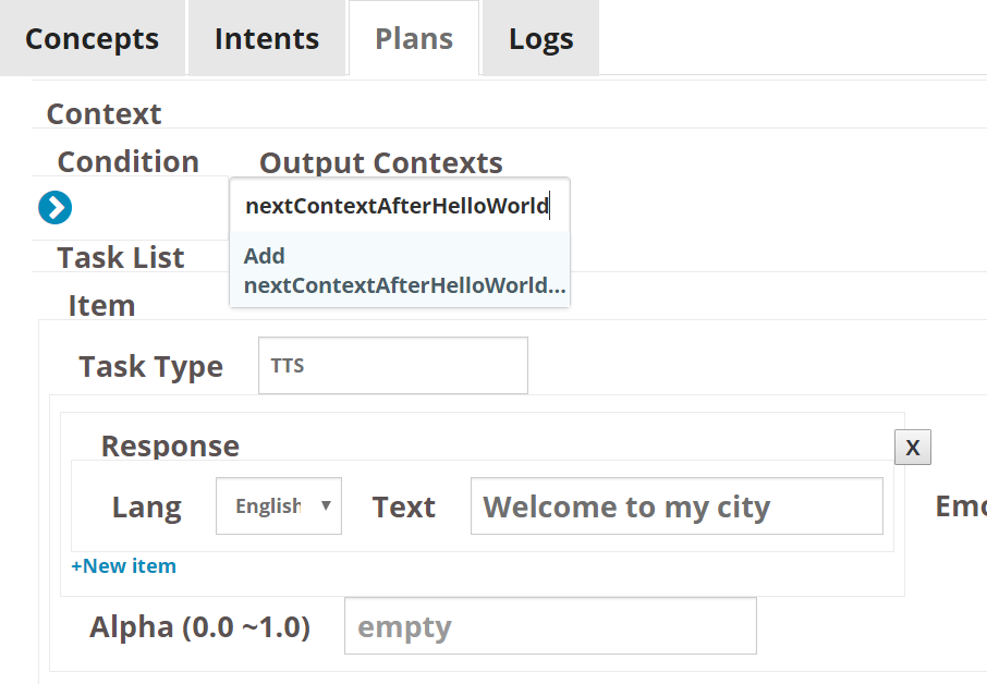

Fig. 38. An example of a customized plan.
Fig. 38 shows how to set the output context of the plan, you can define a whole new plan which has “nextContextAfterHelloWorld” as its input context.
